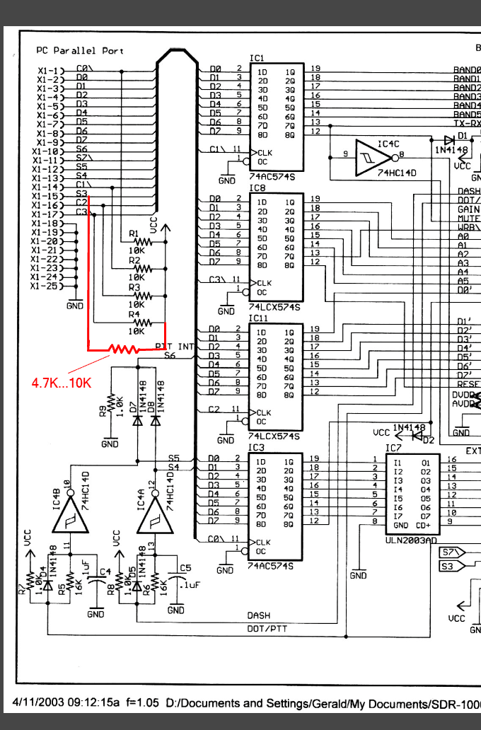

The problem narrows down to the fact that the synthesizer does not produce any output anymore after a power cycle of the SDR radio.
Only PowerSDR restart does not fix it.
Restart the radio, the USB-IO and PowerSDR makes it work again.
A reset of the USB-IO (button) works too.

In any case it is necessary to connect S3 signal with VCC(+5V) via resistor 4.7K...10K (see LPT-port). The adapter monitors the voltage of the S3 signal for the power cycle of the SDR radio.

Hi Nikolay,
I already connected S7\ to +5 over a 4.7K resistor.
The problem was that the +5 was from the PC connected (USB)
I changed that to the internal VCC from the SDR radio and all works fine.
It shows that the 4.7K resistor from S3 to VCC is not necessary.
Many thanks on behalf of a dozen ham operators here in the neighbourhood and in the Caribbean.
We got operational radios again!!
73,
Han
